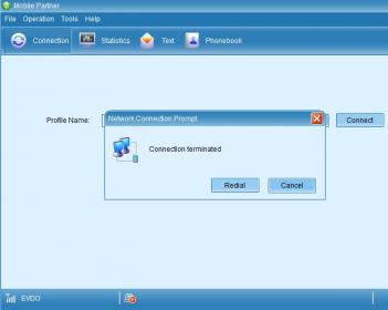

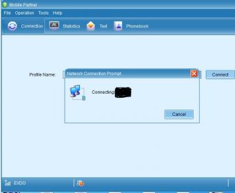

    hello,
    when I try to connect to my new internet provider using Mobile Partner, the huawei EC156 modem tries to connect but never connects. It nevers reaches the servers of my new internet provider. I have tried with several other same EC156 modems. It works when putting the configuration of the old internet provider (the one that sold me the modems), but after putting the new provider configuration, it never connects....
    It displays the following message:
    1°) Connecting xxxxx
    2°) Connection terminated
    Please help
