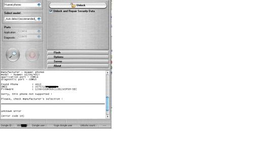

    auto mode is ok ,but cannot unlock, erroc code19
    manual not work, in boot mode dc phone not found ..
    help
    Detecting phone :
    manufacturer - Huawei phones
    model - Auto detect
    Found Phone : 401I
    IMEI : 35753101058xxxx
    Firmware : 120eV100R005C22B126SP09-SEC
    Sorry, this phone not supported !
    Please, check manufacturer's selection !
    still no1 can help?

        DC - Unlocker 2 Client 1.00.0391 beta
        Detecting phone :
        model - Auto detect
        Found Phone : 401i
        Model : Huawei U120e/401i
        IMEI : 3575310100xxxxx
        Firmware : 120eV100R005C22B148SP01-SEC
