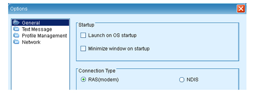

    i sucessfully unlock my modem ..modem is working just fine with other operater sim etc but one problem i just notice
    RAS and NDIS option is missing...after firmware upgrade...
    isnt this firmware doesnt support ras and ndis option ??? or something wrong ??? just wondering ...want to knw ...
    thank you
    here is the screen short of ras and ndis which showing before firmware update but after firmware upgrade its vanish
      i reinstall my dashboard then i tryed diffrent huawei dashboard latest version but result is same no ras and ndis option
      please help me dc-team

          Ok after lots of google research i got to knw that this problem with firmware…latest firmware will fix this problem..
          here is the solution i got
          AT^SETPORT=”A1,A2;10,12,13,16″
          HUAWEI E3276 modem a PC UI Interface, DIAG, MODEM port open.Ndis and ras
          Source here http://forum.mikrotik.com/viewtopic.php?f=2&t=76388
          I dont no this command safe to try or it will disable maybe cd or sd ..can u pls suggest me how to restore default if any prob permit

                Finaly i update my airtel 4g E3276
                firmware with E3276_21.263.03.00.07 (Telia
                Sweden) download firmware here http://unlock4modem.in/?wpfb_dl=273 and its working fantastic also NDIS
                and RAS option is came back ..so my
                router will work
                everything is working fine…….i
                checked. imei number… serial
                number…sd card cd rom…….. 2g 3g 4g all net is working with other
                operater sim
                finally im very happy that i was
                selected good firmware to my airtel 4g
                e3276…
