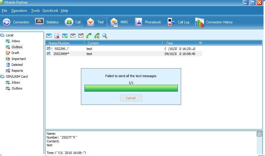

      HI!
      Unlocked e1550 working fine bit problem in sending message receving is ok.
      Screen short pasted here. Please help? Using AT display shows no carrear like situaltion/./
      [IMG]C:\Users\Pawan\Desktop\Failed to send all the text message.jpg[/IMG]

        Hi!
        Unlocked modem e1550 working fine but bit problem sending message receving is fine. AT command AT display respones is No Carrear. Please how to get back and send sms somoothly....
        Regards,
        Pavan
        • #19
          Image fail to send all message?
          Originally posted by Console View Post
          Hi!
          Regards,
          Pavan
          Hi here is image attatch not sending message
          Reagrds
          Pavan
