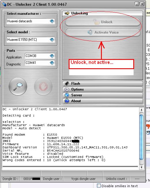

Huawei E1550 (MTC) Ukraine, unlock booton not active
  • Huawei E1550 (MTC) Ukraine, unlock booton not active
    DC - Unlocker 2 Client 1.00.0467
    manufacturer - Huawei datacards
    model - Auto detect
    Found modem : E1550
    Model : Huawei E1550 (MTC)
    IMEI : 359124036044xxx
    Firmware : 11.608.14.11.222
    Dashboard version : UTPS11.300.05.15.143_MAC11.301.09.01.143
    Serial NR. : B54CAA1010700646
    Voice feature : disabled
    SIM Lock status : Locked (customized firmware)
    Wrong codes entered : 10 (unlock attempts left : 0)
    how to unlock this modems?
    Plz.help.
    Tnx.

    Please download version 460 http://www.dc-unlocker.com/downloads/get/C2LALh and use it instead of version 467.
      Tnx, Mr. panatar!
      modem is unlocked!
