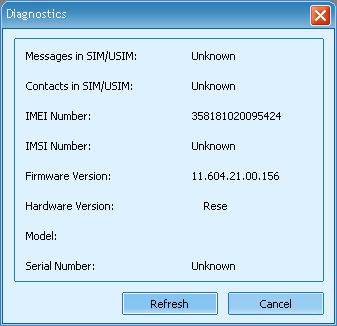

      I had already upgrade the E156G with all firmware which is belong to E169 but the modem wont work I think the modem is damaged when I upgrade it with Dashboard (E160Update_11.604.21.00.156.B409.exe). and when I checked the hardware version is keeping said : Rese
      Check the attached screen shot.
      I need any solution that can fix my E156G
      Thanks in advance
        Thanks in advance
        Install the dashboard of another model is possible, but you used the firmware from another model (apparently the same).
        If the modem is not correctly detected by the O.S., may be seriously damaged (check the active COM ports).
        Need to find a firmware version for that specific model and try.
