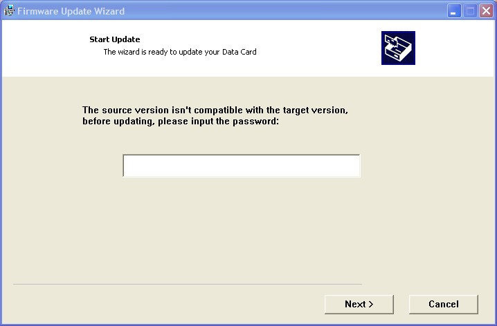

    Sir,can u help me.....i want upgrade firmware vodafone huawei k3565 to e160 but ask password!!!please sir send me password for upgrade to e160.
    MODEL:K3565
    Thx's sir before!

    ScreenShot
      Firmware code can be generated only for most supported Huawei modems (other manufacturer modems can not generate it). In order to generate the firmware code you need to start dc-unlocker software , select your modem manufacturer (Huawei). Then go to unlock tab and select “generate firmware code by imei”. Enter the imei number which you can find on your modem. Double check if imei is correct, because unlock code will be calculated by imei you enterred. Then press do job. Or if your modem is already detected, you can use read firmware code function.
