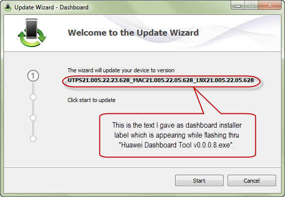

                              • error on version number after flashing
                                I downloaded v.0.0.0.8 and facing wrong version no issue after flashing. The issue is explained in the attachments. I have not found any link inform the issue to the creator, so posting here.
