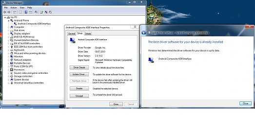

      Hi
      I cant get windows7 professional to install the fastboot driver, when i search for updates, i get the screen below (i hope its readable). Any Ideas how i can install the driver manually?
      greetz
      • #93
        I have successfully unlocked my phone finally . After i installed this driver: http://www.huaweidevice.com/worldwid...oftid=Mzk1MzA= my windows detected the phone while in 2button mode and i could install the drivers as posted in the instructions.
        Thanks for your work.
