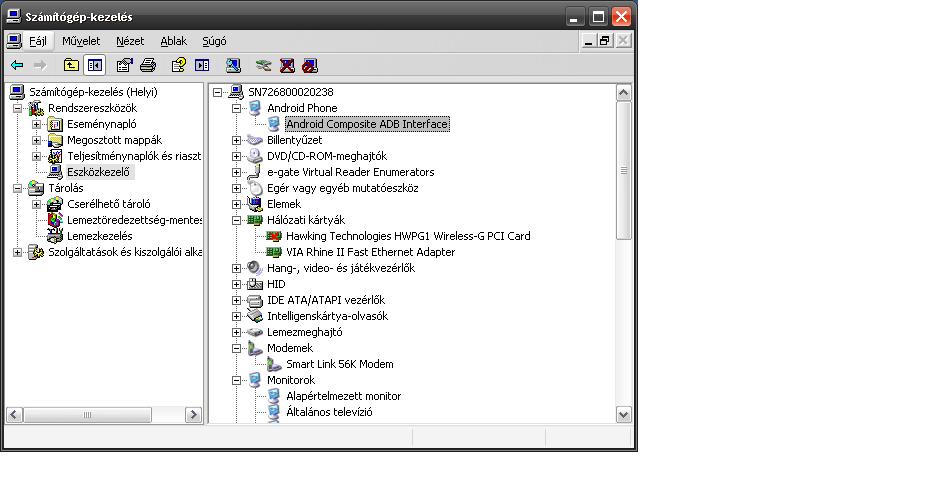

              I do everything what you said, but i not found phone in device manager.
              Picture attached.
                Originally posted by syswind View Post
                Please give me a link i could download a correct driver for this phone, becauese i not found.
                Drivers install from phone.
