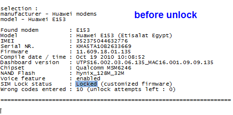

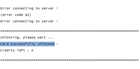

    I unlock E153u1 Etisalat Egypt v11.609.18.01.135 compile date : Oct 19 2010 10:08:52 successfully by 7 credits
    but after unlock modem does not accept the sim card .
    The following message appears :
    you have not entered the correct sim card end Program
    why this happened and what is the solution ?

    Could you copy here what is detected by dc-unlocker?

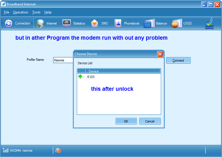

      this is anther modem but same problem
          Originally posted by abumrim View Post
          This is because your modem software was branded and it did not accept other providers SIM card, only the original one. When you use unbranded software, it works fine. You should write unbranded dashboard to your modem that will automatically load when you connect your modem.
            If I write unbranded dashboard did it work wiht oyt any problem ?
              Yes, it will.
