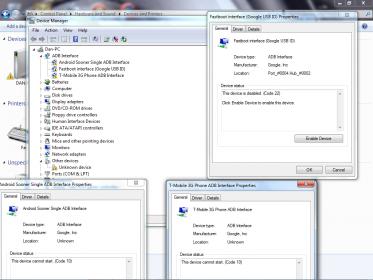

                      After uninstalling the driver and installing the two drivers from this site, the original driver keeps being installed by windows. I can disable it but I'm getting a hazzard symbol on both of them, code 10, driver cannot be started. I have tried all sorts but don't seem to be getting anywhere.

                        First for the bad news. After trying everything I was unable to use DC Unlocker to unlock my T-Mobile Huawei 8180 in Windows 7 64bit.
                        The good news is I used a friends laptop, which has Windows XP on it. It was really quick and easy, no messing about, it just worked.
                        If anybody else is struggling, like I was, with DC Unlocker and Windows 7 64 bit, my advice is to just do it on XP even if that means using a friends computer. Spent 2 days messing with DC and in the end, on XP it was all done in under 5 minutes, including installing DC and XP drivers. Great little bit of software for XP.
