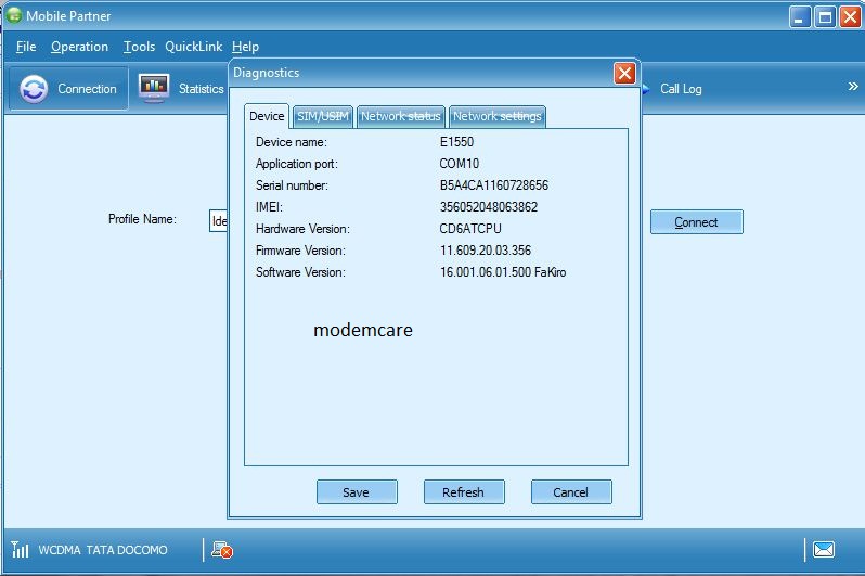

    After unlock :
    with Diffrent sims test: check attachment
    Thanks DC team!!
