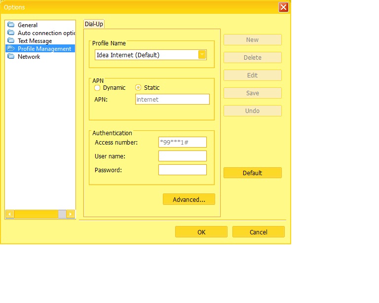

    but its prob . its accept new sim but not edit or add new Apn. plz help me its urgent
    this is prob . picture
      reinstall software or use Mobile Partner specially for huawei modems.

            Dashboard update
            YOU HAVE TO UPDATE YOUR DASHBOARD & FLASH THE DEFAULT IDEA NETSETTER DASHBOARD.UPDATE IT WITH MOBILE PARTNER.
            LINK:: http://www.dc-unlocker.com/downloads...mised_managers
