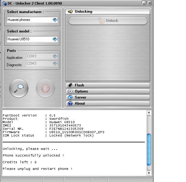

      I have this one and can't unlock. Drivers installed (in device manager is Android Sooner Single ADB Interface), using DC-Unlocker 1.00.0890 and get this
      Code:
      DC - Unlocker 2 Client 1.00.0890
      Detecting phone :
      manufacturer - Huawei phones
      Fastboot version    : 0.5
      Product             : swordfish
      and after info to press Vol - have this
      Code:
      Phone not found !
      any help
      BR

              I tried all procedure on two other PC. On both of them after this
              Code:
              Detecting phone :
              Product             : swordfish
              is info about "Vol-" and get this
              Code:
              Disk write error !
              Phone connected direct to PC
              Tried also with ver 1.00.0805 but the same as above

                    hehe I don't know how to explain this ...
                    I tried on fourth PC but with Win 7 64bit. I did exactly the same steps as before and.... phone unlocked without problem
                    Thanks
                    BR
