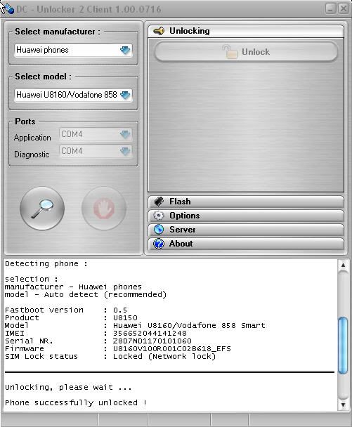

    Procedure:
    Hold vol down and power
    Connect Usb
    Detect Phone
    Unlock
    Always to God be the Glory..
    +1 confirmed
    manufacturer - Huawei phones
    model - Huawei U8160/Vodafone 858 Smart
    Fastboot version : 0.5
    Product : U8150
    Model : Huawei U8160/Vodafone 858 Smart
    Done.
    Confirmed.
      Thanks! Unlock done!
      press "vol-" + "pwr"
      insert battery
      connect usb cable, install "Pulse 2.1" driver (show network adapter icon in driver )
      press search and unlock

                      Step by step guide for Huawei phone unlock
                      DC - Unlocker 2 Client 1.00.0842
                      Detecting phone :
                      Product : U8150
                      IMEI : 356652049461575
                      Serial NR. : Z8D7ND1212903932
                      Firmware : U8160V100R001C02B618_EFS
                      SIM Lock status : Locked (Network lock)
                      Phone successfully unlocked !
                      Credits left : 0
                      Please unplug and restart phone !
