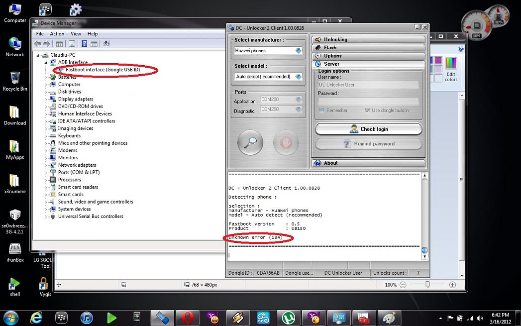

    Hello i try to unlock manny times this orange and always unlock failed. Unknoun error 134. Try diferent PC diferent Cables, different Operating Systems (win XP Win 7 ) an always error. Please Help. Software version is u8180v100r001espc224b630 and Android 2.2.2
    Sure you follow this procedure step by step:
    Could you try to use older dc-unlocker software version?
      Turn off the phone, remove battery for 20 seconds, then place it back.
      Then put phone in fastboot mode ( guide: http://www.dc-unlocker.com/huawei_ph...rials/fastboot )
      Follow the instructions: http://www.dc-unlocker.com/huawei_u8...lock_procedure
      Make sure you install drivers from the same procedure link. Otherwise - you will not unlock your phone.
