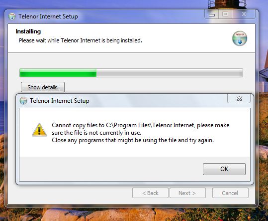

        I tried to update my dashboard with this software but something is wrong with my modem now...First i make a copy of all files from virtual CD (and i made an iso file with HUAWEI DASHBOARD TOOL v.0.0.0.8 to). The new dashboard didn't work well for me and i had to restore my original one, and i did it. When i put my modem to USB program starts but can't complete installation because i'm getting message: Cannot copy files to C:\Program Files\Telenor Internet, please make sure the file is not currently in use. Close any programs that might be using the file and try again.. I have to computers and getting same message. My modem is Huawei E303s-2. You can see screenshot in an attachment.

            Thanks for your reply but as i wrote i have two(to was miss spell) computers and getting the same msg! Everything was perfect until i did this thing with dashboard read/write. I tried to restart comp. and remove software and now even AutoRun won't to start as before...Definitely is something wrong with dashboard...

                I did, the one from Huawei official site, with drivers for WIN8...and also tried one more but now just AutoRun won't to start...i have to start it manually...Any idea? Thanks for your help !
