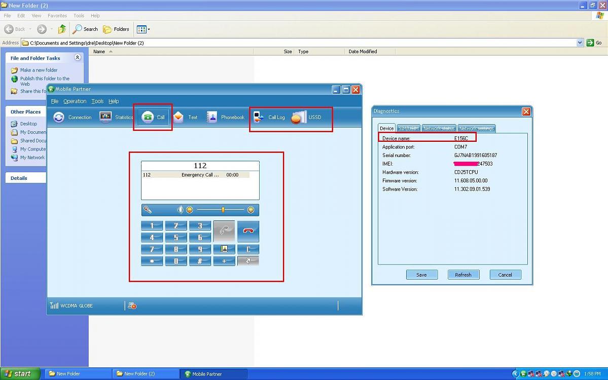

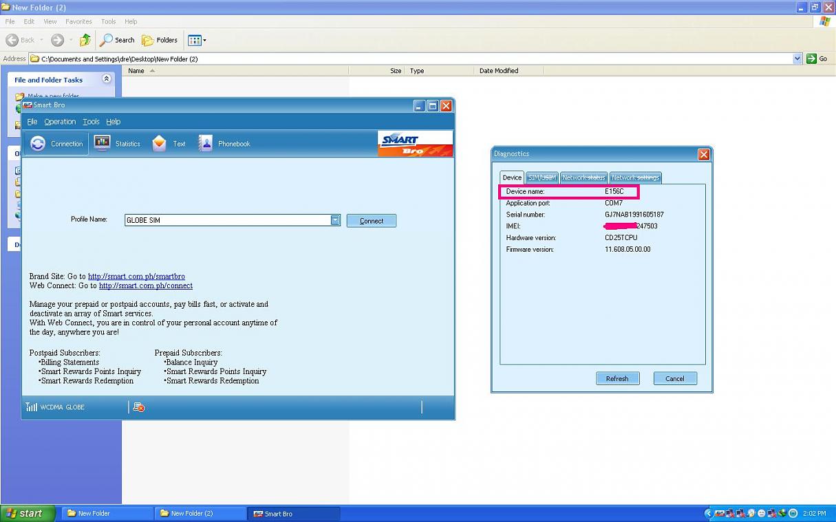

                          succesfull flushing on mga huawei e156c with some mod
                          txn team
                          before
                          after
                          br
