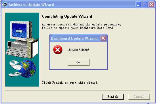

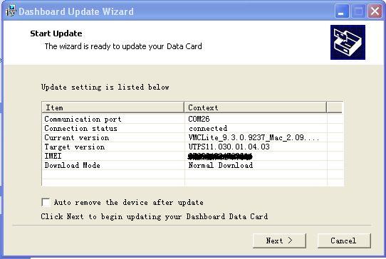

          Thanks Fakiro, but still having problems here.
          Everything removed from PC, plug in USB modem, wait for it to detect and then stop Voda software from running.
          Then I run the new dashboard software and I get this
          (see huawei1.jpg).
          After I start the wizard, I get this error message
          (see huawei2.jpg)
          Am not sure why it won't run - your advice much appreciated
            ...strange...but it must go!
            STEP *REVISED*
            How to Upgrade:
            1-Modem must be correctly installed (not only cd-rom device...need to have software installed into PC...vodafone or huawei m.p.)
            2-Remove sim card
            3-Connect modem to usb port
            4-wait for o.s. plug&play detect it
            5-CLOSE (not uninstall) totally any software utility that you have previously installed on the PC (vodafone, Huawei m.p. -as point1-).
            6-CLOSE any Autorun software that should be start from E169
            7-Start Upgrade
            8-IMPORTANT: Do not remove device until upgrade process end!!!
              Fakiro,
              U R a hero!
              Finally got success in flashing the Voda software (its a very durable beast).
              I did it by using another PC, but I followed your steps to the letter.
              The key was to ensure I'd installed the Voda F/W on the PC before attempting to overwrite it. Strange but this didn't work on my laptop?
              Anyway you deserve a medal - let me know if I can help you some day
