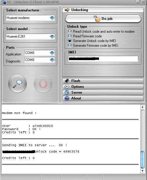

    I am tyring to unlock Huawei e261 but I am not being allowed to "read unlock code and enter to modem" so I used the "generate code by imei" feature.
    The problem is that the software does not tell you how to enter the unlock code. I tried using AT^CARDLOCK="49953576" but it is not allowing me. I am getting cme error : operation not allowed.
    I attached a screenshot.

    Sorry, but you cannot enter unlock code using DC-Unlocker software.
    If you want to unlock this modem, you can do it in 2 ways:
    1. Detect modem with DC-Unlocker software, go to Unlock tab, select "Read unlock code and auto enter to modem", click "Do job".
    This will unlock your modem directly.
    2. Launch DC-Unlocker. Select:
    Manufacturer: Huawei modems
    Model: E261
    Go to Unlock tab, select "Generate unlock code by IMEI", enter IMEI number of modem, click "Do job".
    After you generate unlock code, you should be able to enter it in modem connection software when there is other providers (not original) SIM card inserted in modem.

        After you connect modem to computer, it starts to install drivers and asks to install modem connection.
        So, install it, then launch it. Make sure there is other providers (not original) SIM card inserted in modem.
        Software should ask for unlock code. Enter unlock code there.
        If it does not ask for unlock code, then you will have to detect modem with DC-Unlocker and unlock it directly.
