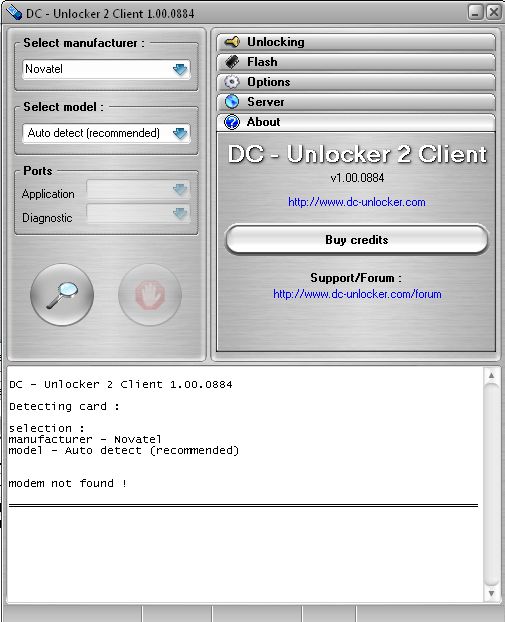

    Was wondering if you could support unlocking the Mifi 4510L Novatel Hotspot which is locked to Verizon. I have run your DC-Unlocker software, and I can not get the software to detect the router. I can access the router online through the 192.168.1.1 web browser once hooked up, but aside from that I just get a modem not found error. I have tried to select other Novatel units, but this does not work.

      Hi there;
      No it does not show under modems or ports. On windows 7 it comes up under "unspecified device". It shows as a Novatel Wireless 4g device, and it has the check mark to show the drivers are working correctly
      I have attached a screen shot of DC Unlocker...
      Thought's ?
      thanks
      Dwayne

        Sorry, if you do not see it under modems or ports you will not be able to detect it by dc-unlocker.
        Try to check, maybe any drivers are missing or not installed.
