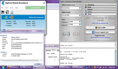

          I too have the Telstra branded Sierra Wireless 320U
          and DC Unlocker is refusing to detect it.
          Windows 7, 32 Bit.
          Installed, Rebooted, Not found.
          Went in to Device Manager, found it on COM6, So i manually set it to COM6, Told it it's looking for a 320U, Still cannot find it.
          See Attached Picture
          Any ideas?

                  This is the only modem.
                  In Device manager it appears under Modems as "Sierra Wireless WWAN Modem"
                  In the [Modem] Tab is shows Com6.
                  Hardware ID: USB\Vid_0f3d&Pid_68aa&MI_04
                  In Ports it appears as:
                  Sierra Wireless AT Command Port (COM4)
                  Hardware ID: USB\Vid_0f3d&Pid_68aa&MI_03
                  Sierra Wireless CNS Port (COM3)
                  Hardware ID: USB\Vid_0f3d&Pid_68aa&MI_00
                  Sierra Wireless DM Port (COM5)
                  Hardware ID: USB\Vid_0f3d&Pid_68aa&MI_01
                    Try to detect it while Application port is set to COM6 and Diagnostics port to COM5. The other way around than in the screenshot that you've posted.earlier.
                      Manufacturer SierraWireless
                      Model AirCard 320U
                      Application COM6.
                      Diagnostic COM5.
                      Modem not found.
                      Could Telstra have put some unusual firmware on it that's stopping it's detection? If so, how could i fix that?

                          I Used the Telstra Branded ones that install when the device is first plugged in.
                          Is there an alternative to the Telstra ones? if so, where can i get them?

                              have been very busy lately. i have since tried on another 2 computers running Win7 x64. a laptop running Win7 x86. and a laptop running XP SP3 x86.
                              "Modem not found" on all systems.
