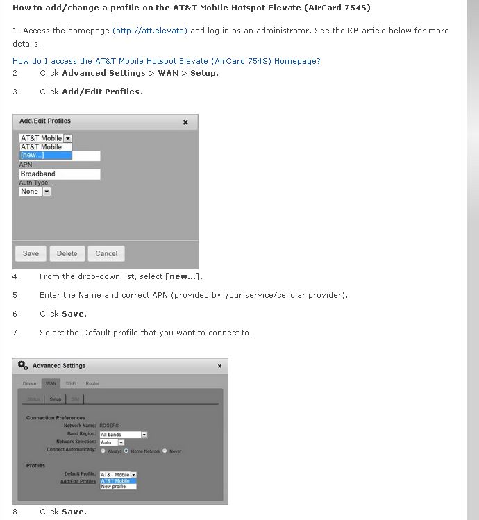

              Only ATT firmware available at Sierra and new owner NetGear, but found details abut changing the start profile of the device
              Change Profile of ATT AC754s
              http://mycusthelp.net/SIERRAWIRELESS...6sSessionid%3d
              No firmware change required to bypass ATT device start page that requires an account sign in. Follow instruction linked above in order to change profile or modem's start page and APN to the required/new carrier sim card.
              I change profile and all working great.
                Thanks for your help or I would not have known where to start searching for solution.
                cheers

                  The website about bypassing the ATT login is no longer available. Anyone manage to save that information?
                    See this:
