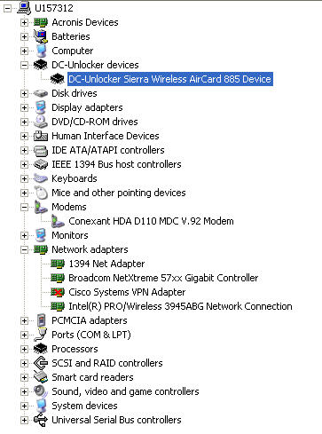

    4) Now, my device manager looks like the picture attached. So, it looks as in your help page for special drivers.
    5) At this point the card is not more visible under Modems nor under Network Adapters, nor under Universal Serial Bus controllers. It see it only under Dc-Unlocker devices.
