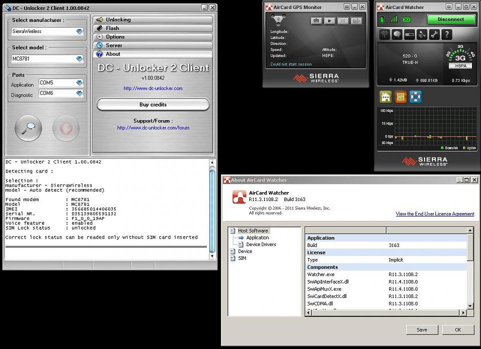

    I successfully enable voice feature in my WWAN MC 8781 using DC-unlocker 2 client v1.00.0842
    After Voice enable setting there are some problem.
    GPS can't working and there is only Aircard watcher (build 3163) can connect to internet (the other version can't connect to internet). But this virsion don't have dial pad.
    Before update voice enable GPS feature is working, And there are many version of Aircard watcher can connect to internet.
    How can i do for use GPS and dial pad.
    Thank's a Lot.
    Firmware F1_0_0_19AP
    Device type MC8781
    Aircard Watcher R11.3.1108.2 build 3163
    Voice activation does not change anything to modem that is related to gps or software. We never had problems with it.
      this is my screen capture
      is it want to be firmware update?
        Yes, maybe need to update firmware.
