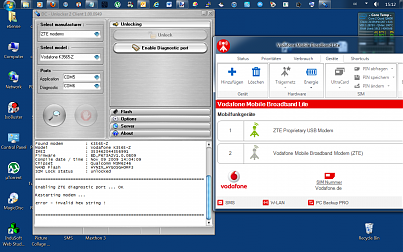

    I have a Vodafone K3565 -Z ZTE USB 3G Modem unlocked by DC_Unlocker software and used with Eplus Germany SIM-card to days ago, I heve sent 3 or 4 SMS, after that the Join AIr was crashed. from this moment the Modem does ot recognize any SIM- Card. the Vodafon Card too. I still get an error: no SIM is installed. DC Unlocker recogneis the modem
    DC - Unlocker 2 Client 1.00.0460
    manufacturer - ZTE datacards
    model - Vodafone K3565-Z
    Found modem : K3565-Z
    Model : Vodafone K3565-Z
    IMEI : 353462044356991
    Firmware : BD_P673A2V1.0.0B09
    SIM Lock status : unlocked
    the Ports are corrected configured.
    ANY IDeas , Why this messy thing doesn'take any card?
    the Stick ran just fine antil last two days.
    Thanks for you Help
    cu gaendalf

    Use latest DC-Unlocker software version and unlock your modem: http://www.dc-unlocker.com/downloads/get/l7J5OhI
    Make sure there is other providers SIM card inserted in modem.
      unfortunately the same, but a new one error and the card is AT&T
      thanks for replay cu gaendalf
        Is there other providers SIM card inserted in modem at detection time?
          yeah is it... i have at first time unlocked the modem with this card. without any problem. may be it is a hardware issue. or i suppose the vodafone has blocked the imei number of the card after using an other provider card. vfsupport says u have to go to vf store and let check the card.
            Yes,it is possible that its a hardware issue. Or IMEI is blocked.
            If DC-Unlocker shows SIM lock status as Unlocked, then modem is unlocked.
            I suggest you to try another connection software. If it will not work, then sorry, but do not know what else to try.
