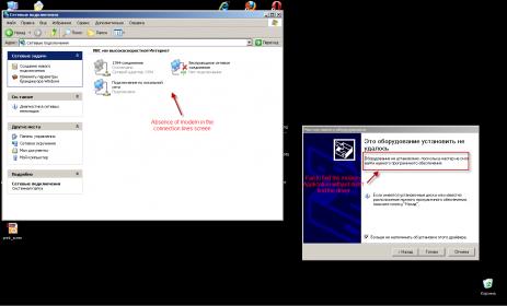

          I have the problem with modem detection. First time when I plugged it in USB and software got started, I close the software and started DC unlocker client V 1.00.1005, but the modem wasn't detected. After then, when I plug-in modem into USB again software didn't start the modem and it was unvisible for PC. DC unlocker client still doen't find the modem. Could you assist in solving this problem?

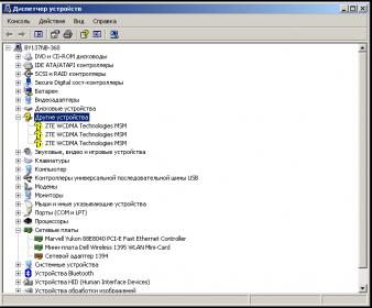

            Can you see MF70 in device manager under modems/ports lines? if so make a screenshot of device manager window with modems/ports lines spreaded or write us here what do you see in there.

                If its plugged via usb, you should be able to see it in device manager. You can access it by right clicking on My computer -> Properties -> Hardware -> Device Manager. Make a screens shot with spreaded modems/port lines and upload it somewhere, because its really hard to see any information in the last screenshot you've provided.

                  please find screen shot you requested
                  • #24
                    Do you see mf70 in My Computer under CDROMS? If so, open it and look for any installation files/drivers, because from device manager screenshot it seems that they are missing for your device to fully function.
