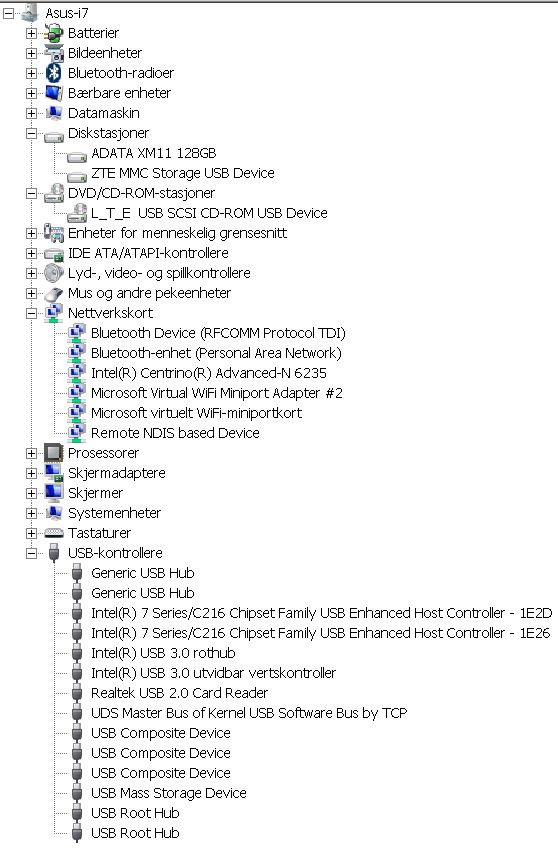

I finally got attached the picture I earlier sent you by mail.
It's correct as you say, - you can see it's listed under nett as "Remote NDIS based device".
But there are only wireless nettwork connected to the pc because Dc-unlocker needs it. Nothing else. Using mf821d for internet is not possible before it's unlocked(?)Attached Files
Okay, try to eject it from my computer area under cdroms and then disable device from network adapters. Check if it appeared differently then in device manager - try to detect it.Originally posted by jan43 View PostI finally got attached the picture I earlier sent you by mail.
How to unlock MF821D
I have now tried excatly to do as you have told me but this is not working !
The dc-unlocker only return with the same statement whatsoever. I have disabled both mass storage and network card but the ZTE is not detected by the program dc-unlocker. I have now used many hours on this but the program is not handling this modem.
After you have disabled it from those lines it should have appeared differently in device manager otherwise it won't be detected? Please contact us by live support chat to check more about this device.Originally posted by jan43 View PostI have now tried excatly to do as you have told me but this is not working !
After it has been disabled from the lines it appears on, it is not detected any other way in the device manager. After it has been removed from the lines in the device manager, it is imidiately detected as mass storage again and if the drivers for the modem is present, it automatically restores the driver again.
