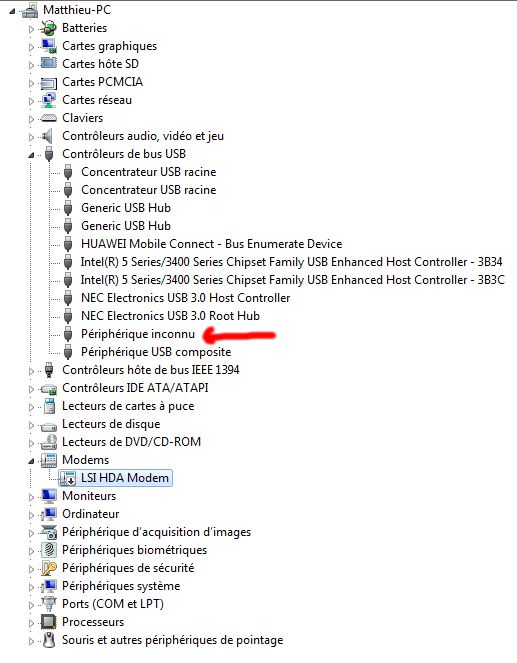

            Hello, here is attached the screenshot of my device manager. The MF60 is the unknown device (périphérique inconnu), on the USB. I have de activated the internal phone modem of the laptop (you can see on the screenshot).
            I have a 3G USB modem, but unplugged it for the detection.
            Still no detection...

              Maybe your device appears under cdroms in my computer? Also are you able to access your devices web gui/panel?
                Hello,
                No weird device on my CDROM tab, except my cd rom, and my 3G usb stick when i plug it in.
                The MF60 wifi correctly works, and i can connect to its web server/configuration.
