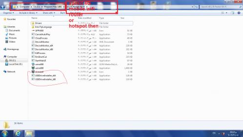

                        when u make auto run the file speed 4g mobile wifi router will be direct to c/ program files if u could upload the whole fine i will be thankfull for ur becuse i am trying from last week to install it but the problem zain telcome locked the usb in some way i tried hacked once and its almost work but i lost the driver again so please try to upload it we may solve it soon and unlock it
                        i attach apicture for mf 91 as an examble but i dont have its modem
                        regards bro

                          Hi
                          I uploaded all of files after install it,That is what you mean?
                          And my Router is locked in (Zain-KSA), like you.
