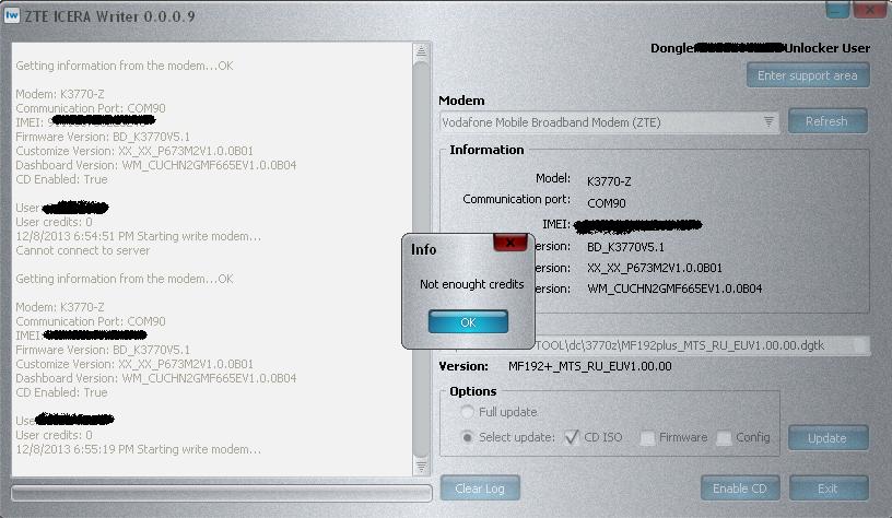

              ow to write this file plz tell me
                Please read this thread: https://www.dc-unlocker.com/forum/sh...ad.php?t=19187
                  plz tell me dc unlocker need credite for write dashboard
                    No, dashboard writing for zte modem only requires to be logged into server.
                        Writing files by this software requires 1 credit unless you have Unlimited Free Writer activation on your dongle
