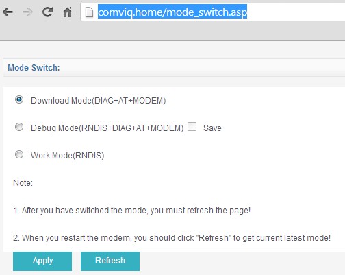

    Start with plugging your modem (with a simcard from another operator) into the computer and let it install and after a while a webwindow should open with the modem startpage telling you to enter pincode (if any) or just say that you need to enter unlock code to use (simlock). Take a note of the site adress which in my case was "http://comviq.home".
    Now you just type a "/" after "home" and type "mode_switch.asp" and the adress should look like "http://comviq.home/mode_switch.asp" (obvisually comviq is the operator for me but if you have another one then you type that one instead)
    After that select "download mode" and apply, modem will now reboot and computer will detect new hardware, you will need to install drivers and you can try https://files.dc-unlocker.com/backen...C83C6FE9621A63 which worked for me. After drivers are installed you should fire up dc-unlocker and select "ZTE modems" and "Auto detect" and press the magnify glass/search button and it should detect modem. After that just make sure you have enough credits (7 needed for this) and try unlocking it. If successful you can now press the "Disable diagnostic port" and modem will reboot (some error might popup with wrong syntax but nothing to worry about)
