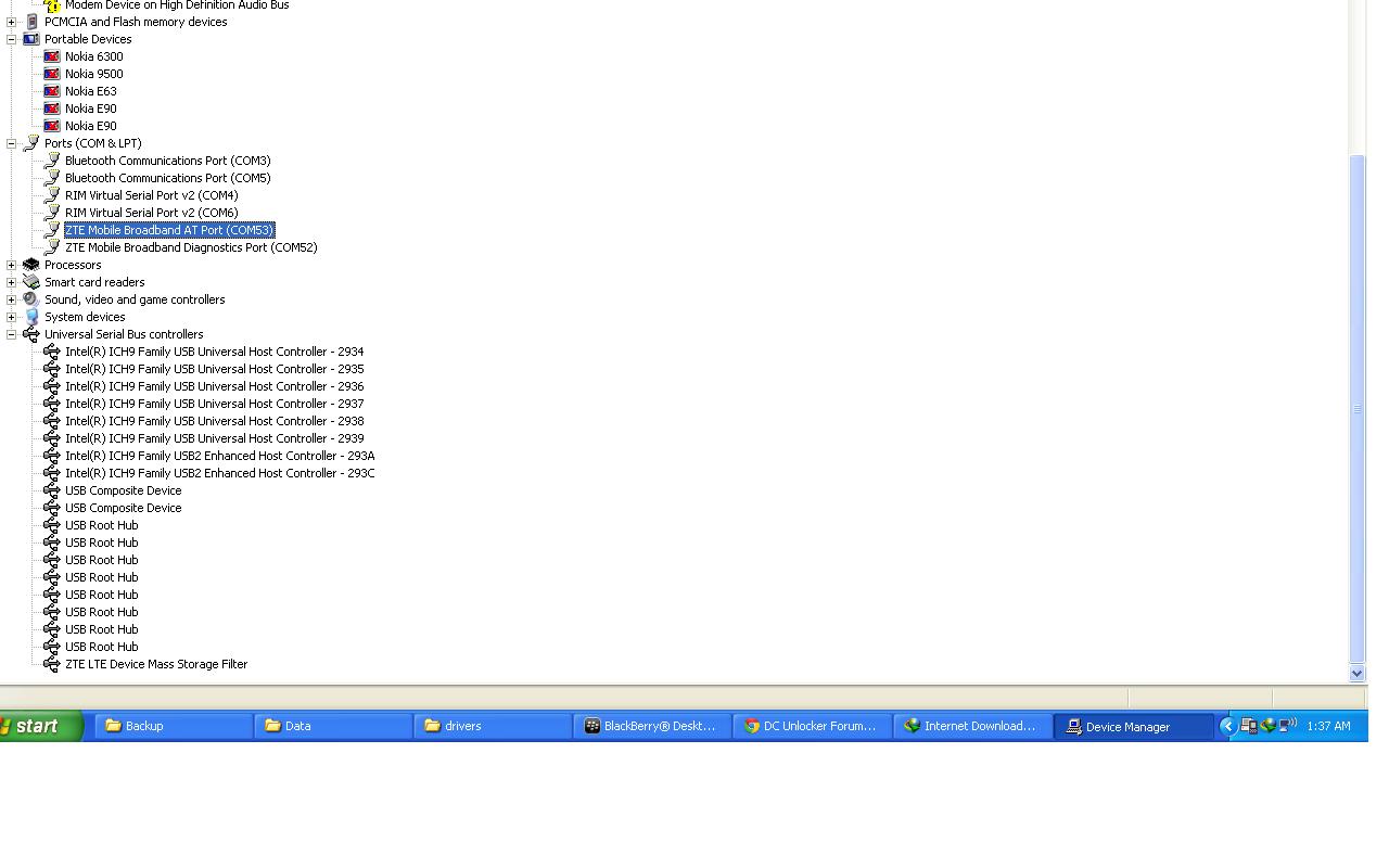

    i have MF90 and i'm using drivers provided by you, and here i post results in my device manager
    all ports is there, i use dc-unlocker (newest) it says modem not found
    how can make it detected and unlocked by dc-unlocker?
    kindly help
    at first there is three exclamation mark on ports, i point it to the driver provided by you, after the last one, when installing the third one it says cannot install driver
    i'm confuse but after unplug and plug again all three exclamation mark is gone and driver is all installed, as the picture before this one, but still dc-unlocker cannot detect my MF90
    try to enable diagnostic port and it says
    Enabling ZTE diagnostic port ...
    No response !
    please advice

      So after you reconnect modem to pc the "!" and "?" marks that belongs to line of your device under Modems is installed correctly? If so, right click on it and select Properties, then open tab and see what com port it uses. It will be your Application com port. Diagnostics port is visible under ports line (in this case COM7). Now select your model manually on dc-unlocker, then type in these com ports in respective fields and then attempt to detect it manually.

        hello did you see my picture attached?
        it already show there is
        1. ZTE Mobile Broadband AT Port (COM53)
        2. ZTE Mobile Broadband Diagnostics Port (COM52)
        3. ZTE LTE Device Mass Storage Filter
        is this three "!" device found the right driver? please kindly see the picture i gave you and make comment what should i do now?
        i make manual selection MF90 and select ports 52 and 53 but dc-unlocker cannot detect my modem for unlock process....

          Try downloading version 1.00.1057 and also DC uninstall device software. Run the version 1.00.1057 software, connect the modem and use the DC uninstall device software, select all the ZTE ports and associated hardware ports. Once uninstall, try to use the version 1.00.1057 software to try detecting it, it should detect the modem after that.

            Drivers of MF90 were updated yesterday, please redownload them and reinstall your device on pc, now the third line should/will install and device will be detectable, incase you still won't be able to detect it let us know, we will check it closer here.

              We have made a beta software version for you, please contact us by live support chat ( https://www.dc-unlocker.com/contacts ), then we will be able to provide it for you to unlock MF90.
