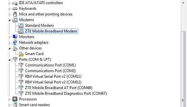

    Why do you click it? If you want to unlock it follow this guide: https://www.dc-unlocker.com/zte-mf90...d-unlock-guide device must be visible in device manager under modems and ports lines for it to be detectable, please check it.

        Okay, then what you can tell about other information that i asked for?

            Okay, right click on your device that appears under modems line, select properties, then select modem tab and see what com port is shown there. Open dc-unlocker software, Select manufacturer and model manually this time. Write in Application field port that you see in mentioned location in Diagnostics COM47 then try to detect it. If it won't be detected Download : dc-unlocker_client-1.00.1057 https://www.dc-unlocker.com/downloads and detect with it by same method.

                It is still locked because you haven't read the guide that i gave earlier. You can see at the end of the guide that device restart/reset is necessary to complete procedure.
