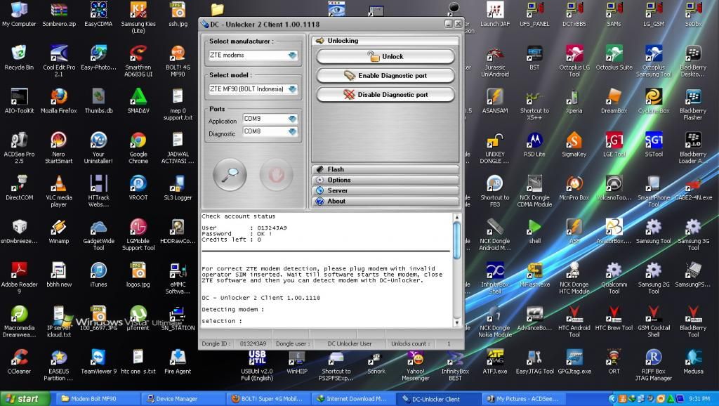

    Today i receive modem Bolt ZTE MF90 to unlock,i try with my Dongle DC Unlocker but can't unlock bcoz no credit?im confusing why i use dongle dc unlck can lost credit ? necessarily this dongle unlimited right? how this can happen? and try with Infinity box with free credit 15 lost again after i try to unlock this MF90 with result still LOCK condition!Please team ceckmy problem.and see this pic

      this use with my dongle DC Lite
      Check account status
      User : 013243XX
      Password : OK !
      Credits left : 0
      And this with Infinitybox
      User : 0064C5CAXX
      Password : OK !
      Credits left : 0
      credit lost 15
      i dont understand?
        ZTE software and then you can detect modem with DC-Unlocker.
        DC - Unlocker 2 Client 1.00.1105
        Detecting modem :
        manufacturer - ZTE modems
        Found Applications port COM9
        Found Diagnostics port COM8
        Found modem : MF90
        Model : ZTE MF90 (BOLT Indonesia)
        IMEI : 862927022705934
        Firmware : BD_BOLT_MF90V1.0.0B07
        Compile date / time : Dec 19 2013 11:39:49
        Chipset : Qualcomm
        NAND Flash : H9DA2GG1GJAMCR
        Insufficient credits !
        Error code 61
        unlock failed !
        This case i use Dongle DC Unlocker Lite,whythe problem credit show?when should i use dc unlocker dongle does not recognize credits or unlimited right!
          Unlocking Bolt indonesia MF90 requires 2 credits as shown in price list for dongle users.
