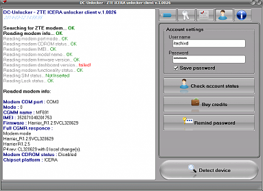

    This is the log of my two modems that do not work
    ++++++++++++++++++++++++MODEM 2 and 3++++++++++++++++++++++++++++++++++++++++++
    Searching for ZTE modem... OK
    Reading modem info... OK
    Reading modem port mode... OK
    Reading modem CDROM status... OK
    Reading modem IMEI... OK
    Reading modem model name... OK
    Reading modem firmware version... OK
    Reading modem dashboard version... failed!
    Reading modem functionality status... OK
    Reading SIM status... Not Inserted
    Reading Lock status... OK
    Readed modem info:
    Modem COM port : COM3
    Mode : 0
    CGMM name : MF691
    IMEI : 352071040201753
    Firmware : Harrier_R1.2.5VCL328629
    Full CGMR responce :
    Modem mode
    Harrier R1.2.5
    P4 rev: CL328629 with 0 local change(s).
    Modem CDROM status : Disabled
    Chipset platform : ICERA
    Lock status: Not locked
    This modem 2 don't conect to 3G SERVICE and not conect to GPRS
    The modem 3 the same problem.
    The modem 1 work perfect.
    Please i need urgent solution.
    Thanks you.

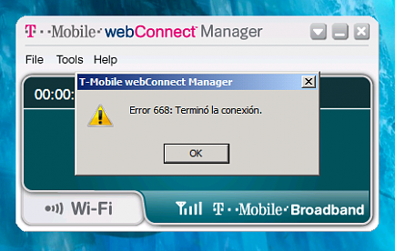

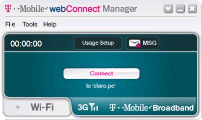

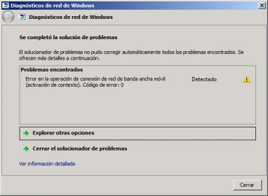

        Can not connect to 3g or edge or gprs or any
        Hi, I have completed the steps above,
        I tried the modem with multiple chips, all detect the type of GPRS signal but fails to connect to any network.
        I have tried to connect with the program that brings the same modem and windows, without any result.
        This problem does not usually happen in the first modem unlocked.
        Please look at the attached images.
          We won't be able to check much from screenshots since they are not in english. Check settings that you use for device connection to another operator, make sure it is set to automatic and not set manually, check apn settings too. Test modem with its original sim and see if it's still same.
