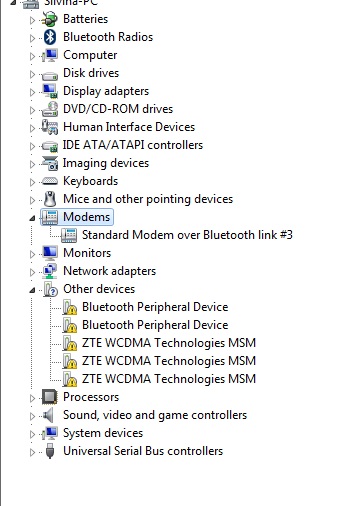

                        I also have the same problem with my MF60.
                        First, DC software was unable to detect my WiFi MF60 - even after I connected to my computer using the USB connection.
                        Then, the battery indicator is gone and nothing is restored after trying AT+ZCDRUN=F (there is simple no answer from the software).
                        So, I know have a WiFi MF60 that DC does not detect and with its battery indicator missing.
                        Please could you help?

                          Connect your mf60 to pc, go to device manager and spread modems and ports lines there. You can make a screenshot of it or write us here what do you see under those lines.

                            Here is - see attachment - the screenshot of device manager with the MF60 connected to the PC via USB connection.
                            What's next?

                              It seems that there are missing drivers on the pc for your device, do you see mf60 in My Computer under CDROMS? If so, open it and look for any installation files/drivers.
