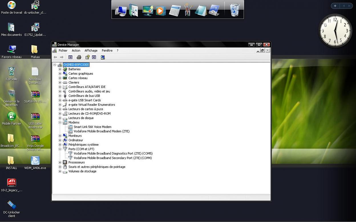

          im connected with WIFI...and only this modem ZTE K3805z connected with my pc.
            Try to use other connection type. According to detect there is huawei router connected.
