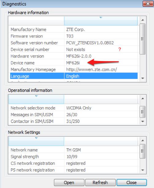

    When I looked at the connection manager it says that this modem is a ...
    MF626i
    Could this be some sort of '' Fake ''
    Ive tried several different connection managers and they all say its a MF626i

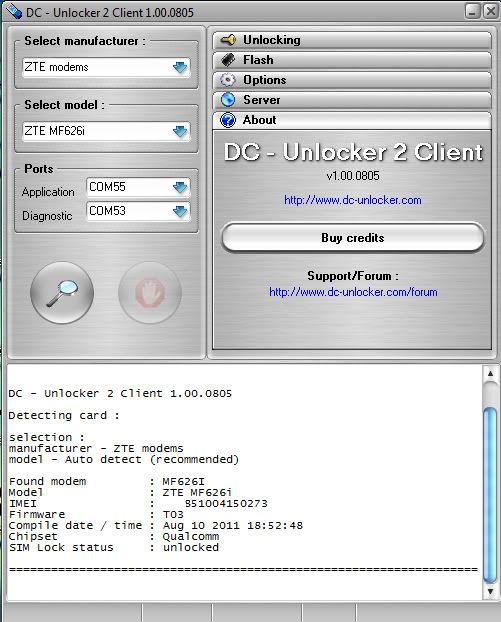

    Could you also try to detect it with DC-Unlocker? Then we will be sure about the modem model.
    You can download DC-Unlocker here: http://www.dc-unlocker.com/downloads/get/R4dfplCx
      Hi and thanks for the comments
      here's the results ....
      its saying the unit is a MF626i

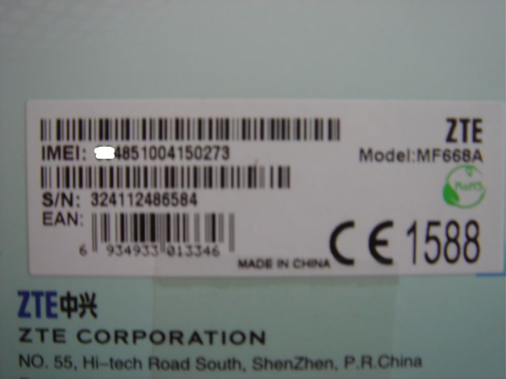

      The packaging shows a MF668A

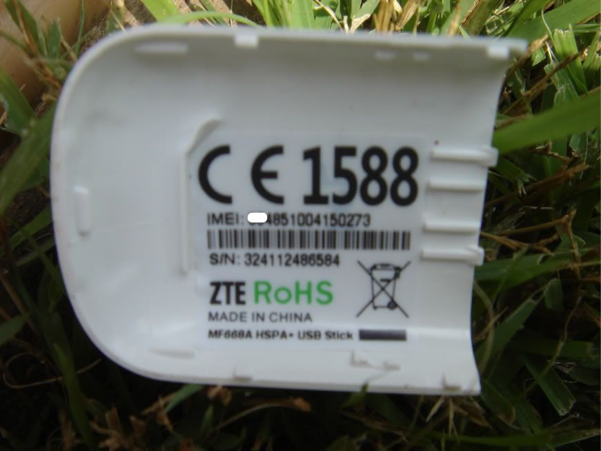

      inside the slid off top says ... MF668A

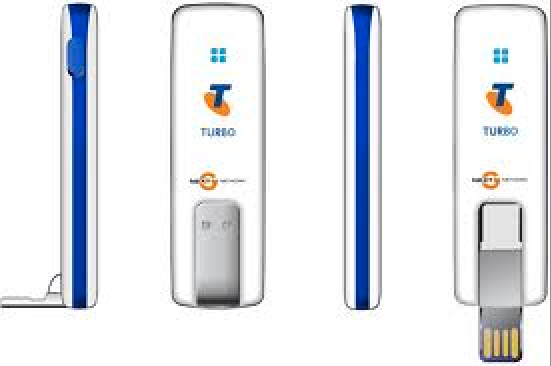

      and a MF626i looks like this ( totally different to a MF668A )

        Apparently, your modem is MF626I. But that does not mean its fake.
        There might be these options:
        You have MF668A modem with MF626I firmware inside modem.
        Manufacturers made a wrong sticker with model name.
        Spoilage
        Fake

          Thanks , Ive tried two 3G SIM cards in it ,
          1. 900Mhz frequency
          2. 850Mhz Frequency
          Both work well , which leads me to think that its some how a MF668A
          MF668A Bands
          HSPA+/HSDPA/HSUPA/UMTS/WCDMA 850/900/1900/2100 MHz
          still a mystery

            Maybe MF626I also supports same bands.
            Anyway, I am not sure about it, maybe these two modems are exactly the same ones.
            Well, but if your expectations are reached, then there shouldn't be a problem for you.

              The Modem is working fine , at first just my suspicious mind working over time
              thanks for your comments - its much appreciated
