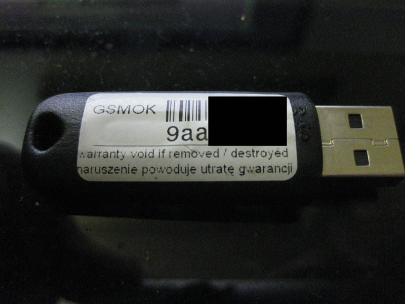

    Hello,
    i've a trouble with DC-UNLOCKER, i'm an old customer, and i haven't used this software for about 2 years, and today, i've installed the lastest version, and when i connect the dongle i receive this pop up with the error "INVALID POINT OPERATION".
    If i disconnect the dongle, the software open and work (so, with limitations).
    I've WIN7 64, but i also tried to install the software on XP machine, with the same problem!
    What i can do?
    You connect dongle/modem or dongle like dc-unlocker dongle? Try to connect it after you launch software if its modem. Reinstalling modem might help.
      thanks for reply,
      i have DC-UNLOCKER USB DONGLE branded UNIKEY, if i connect the dongle after software startup it's not recognized.
      The dongle seems to work correctly, the green led blink during drivers installation and solid at the end.
      The system install the dongle like an HID interface.

                            Could you write your dongle serial number? Serial number that software writes.
                            • #15
                              The dongle ID is: 115B78FE
