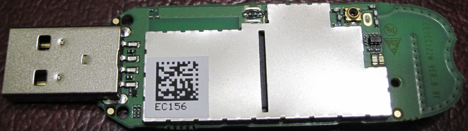

 Googling with "ec122 CE1EC156M" gives many pages where EC122 has hardware version CE1EC156M.
