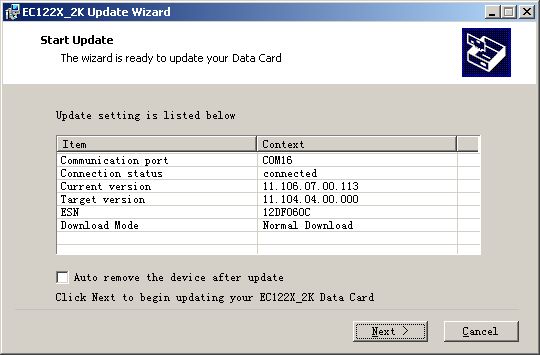

 Your MEID is shown as all zeroes on firmware updater setup as well?Originally posted by emusic View PostI already tried to generate the code but, as I mentioned earlier, my MEID is all-zeros and Unlocker Client replies "Invalid MEID".
 There is no MEID in firmware updater window. In the example provided on your EC156 unlocking page, I see MEID field under "Target version" one. But as I run the updater, it shows ESN instead.Originally posted by Valdemaras View PostYour MEID is shown as all zeroes on firmware updater setup as well?Attached Files
 Try to donwload firmware updater for ec122 and run it to see what information it shows, don't proceed with update, just check the same information screen like you posted earlier and quit updater.Originally posted by emusic View PostThere is no MEID in firmware updater window. In the example provided on your EC156 unlocking page, I see MEID field under "Target version" one. But as I run the updater, it shows ESN instead.
 Unfortunately, it shows ESN too.Originally posted by Valdemaras View PostTry to donwload firmware updater for ec122 and run it to see what information it shows
 BTW, I have QualComm tools package but unfamiliar with them. May they help to modify MEID?Attached Files
