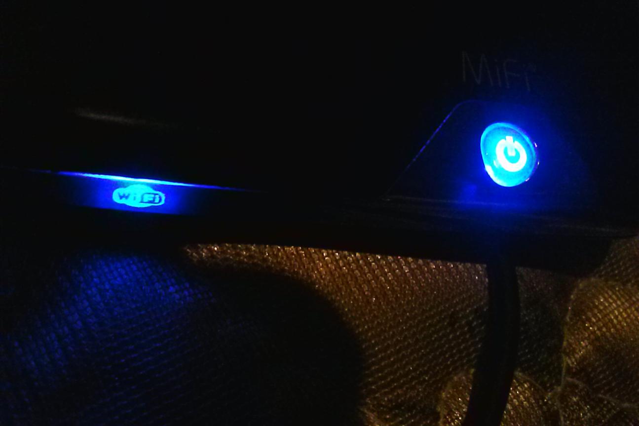

      I have attached some screenshots with SIM inserted.
      Blue solid wifi light (as shown) means available but not connected.
      The other blue light power light is flashing meaning that hdspa is available but not connected, this occurs when chip is inserted even with auto connect activated so i know it isnt connecting irrespective of which APN settings are inserted.
      I also turned off auto connect as you should be able to access the landing page while not connected to the network but with the SIM in, irrespective of APN settings. Remember I could insert this SIM prior to the unlock (irrespective of apn settings) and access the landing page and even adjust thoose apn settings, obviously i couldnt connect as it was network locked.
        I forgot to attach a screenshot of the client device, as you can see its connected but the modem wifi light is solid which indicates nothing is connected but wifi is broadcasting.
