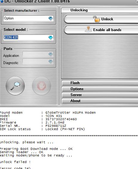

          hello,
          I have same problem.
          I tried too many times.
          reboot and restart.
          everything introduced in this post
          desn't help.
          DC - Unlocker 2 Client 1.00.0416
          manufacturer - Option
          model - iCON 431
          application port -
          diagnostic port -
          Found modem : GlobeTrotter HSUPA Modem
          Model : iCON 431
          IMEI : 357373020836136
          Firmware : 2.7.1.0Hd
          Serial NR. : PS298B92VM
          SIM Lock status : Locked (PH-NET PIN)
          Preparing Boot Download mode ... OK
          Sending loader ... OK
          Waiting modem/phone to be ready ...
          unlock failed !
          (error code 24)
          model - iCON 431
          application port -
          diagnostic port -
          Model : iCON 431
          unlock failed !
          (error code 24)

                Could you try unlocking on other computer ?
                  when the progress bar goes to 50%,
                  the divice reboots,
                  then system found a New hardware GlobeTrotter HSUPA Modem
                  can't install the driver both automatic mode or manually apoint to the dc-unlocker folder
                  I think this is where the problem is in.
                  Any idea?
                  thanks.

                          before unlock
                          almostly unlocking to 50%
                          system prompt me find new hardware
                          can't install the driver for it.
                          neither in GlobeTrotter folder,nor in dc-unlocker folder.
                          ended with error code 24
                          I tried many many times

                            The problem is that the Globetrotter HSUPA Modem driver is missing. Usually it should install from modem. Try to check at option web site, maybe you can find the driver there. Without is dc-unlocker can not unlock the device, thats why you receive error.
