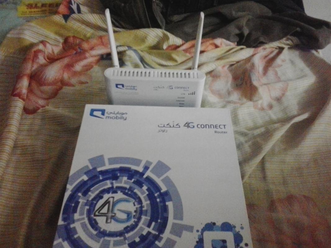

[help] mobily lte wifi router
  • [help] mobily lte wifi router
    does DC unlocker supports this kind of modem??
    MOBILY LTE WIFI ROUTER
    MODEL: QDC
    thats the only info written on the sticker
    it is locked in mobily network
    Please help...
    Have you tried to detect it by dc-unlocker? If it was detected please paste us here its information. Try to detect it as various models and manufacturers.
      i just tried detecting it sir with every manufacturer that is in the list of dc unlocker but no luck
        by the way.. it is connected through Lan cable and not through usb connection
