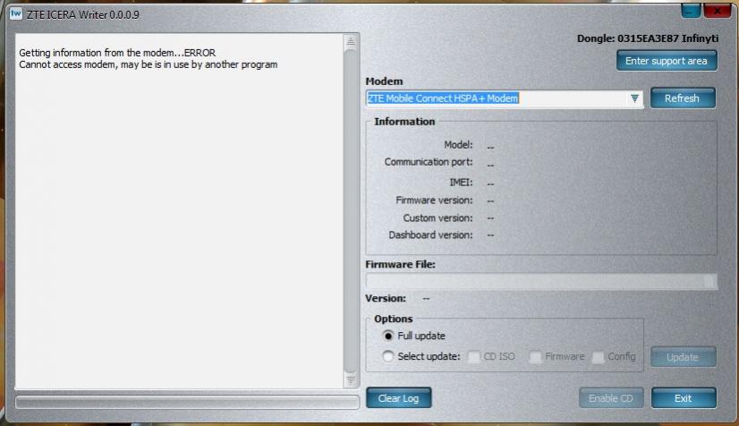

can not flash MF192 always problem with connect
all drivers is okAttached Files
Are you sure that you see modem in device manager under modems and ports sections?Originally posted by gsmpuky View Postcan not flash MF192 always problem with connect
all drivers is ok
Maybe modem software or any other process left running at detect time?
Maybe there is other modem connected? If so, disconnect it and try detecting then.

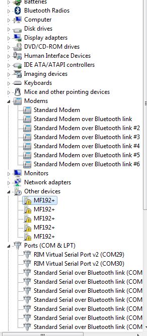

then, in device manager, it asks for driver of mf192+, but it could not find one.
i have attached screen shot of the same.
what should i do now?Attached Files
Try to apply these drivers from here - https://files.dc-unlocker.com/backen...81454F410C791F for your device.Originally posted by genisuresh View Posthi,

Getting information from the modem...ERROR
Cannot access modem
Getting information from the modem...OK
Modem: --
Communication Port: COM26
IMEI: 911133700430751
Firmware Version: --
Customize Version: --
Dashboard Version: --
CD Enabled: False
what to do??
Device manager screenshot:
