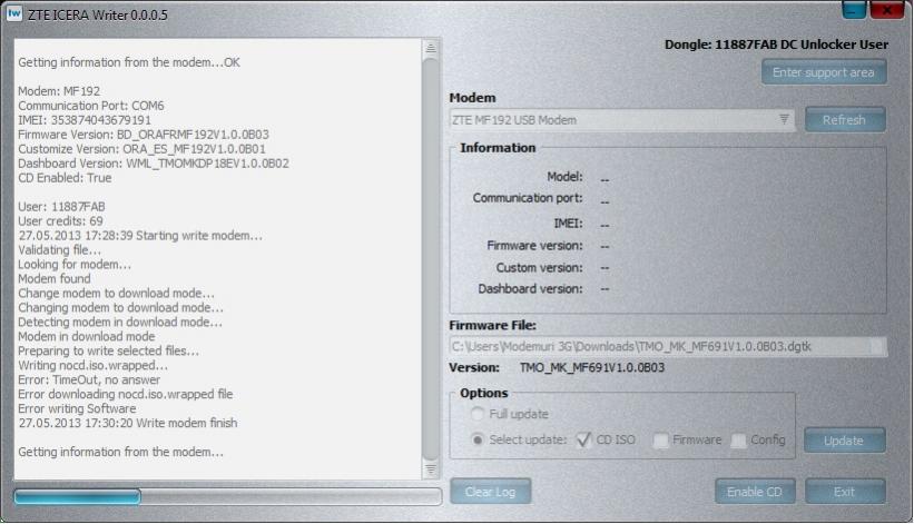

I have been trying to update the firmware on my MF192 dongle which has unlocked fine, mine is T-Mobile software. I downloaded the firmware software from this post and it keeps saying Dongle Not Found. The unlocker tool worked perfectly.

Could you make a screenshot of the error please and paste it here? Do you connect your dc-unlocker/rocker/vygis or infinity dongle to pc before launching this software?Originally posted by hudsonmx View PostI have been trying to update the firmware on my MF192 dongle which has unlocked fine, mine is T-Mobile software. I downloaded the firmware software from this post and it keeps saying Dongle Not Found. The unlocker tool worked perfectly.

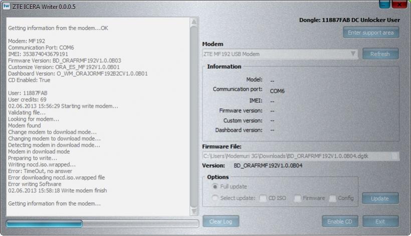

Try to perform Full update not only CD ISO.Originally posted by Erdman View PostI try to write dashboard to MF192 and K3772z

You have downloaded this software recently or much earlier? There were fixes made for this version of the program, so if you had downloaded it quite long time ago, redownload it now and repeat the update procedure.Originally posted by Erdman View PostI tried full update with original firmware, same problem.

Please try to update your MF192 device with respective file from its folder in support area, not the MF691 file as it is most likely not compatible with device. Post a screenshot here as well.Originally posted by Erdman View PostIs downloaded today

same errorOriginally posted by Valdemaras View PostPlease try to update your MF192 device with respective file from its folder in support area, not the MF691 file as it is most likely not compatible with device. Post a screenshot here as well.Attached Files

Please redownload the software from this threads first post, as it was updated, try to work with it.Originally posted by Erdman View Postsame error
