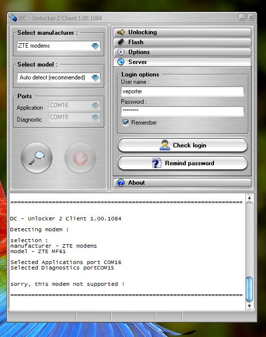

I have checked everything you mention but the modem is still not being detected.
In auto mode it says "modem not found" in manual mode it says "sorry, this modem not supported".
I have provided attachments of the screen grabs.
Please advise.

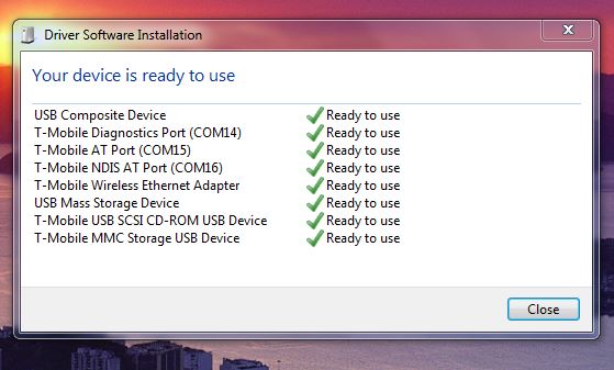

Device Manager
Attached is a screen grab of the device manager with the T-Mobile MF-61 attached with an incorrect SIM installed.Attached Files
That might be because you haven't really installed drivers that i gave. Your device is still detected as t-mobile and it seems either you haven't uninstalled it before installing our drivers or your device got updated via internet. Please perform driver installation correctly and check then again.Originally posted by Porterve View PostAttached is a screen grab of the device manager with the T-Mobile MF-61 attached with an incorrect SIM installed.

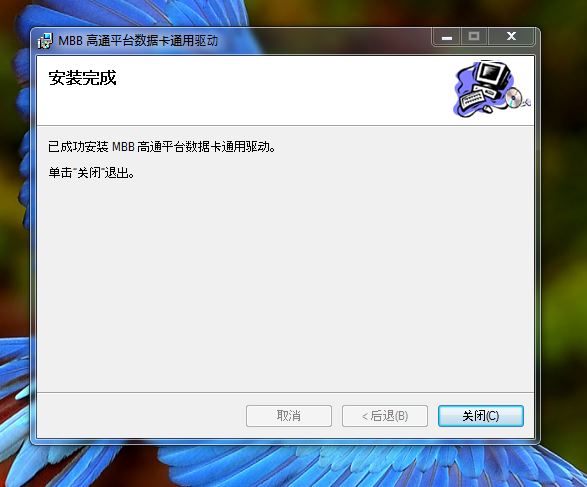

I uninstalled all the programs & drivers that I could find related to ZTE and T-mobile and started again.
I first installed your drivers program - attached is the message at the end of the installation.
I took a grab of the installed programs which shows only your drivers were installed.

Could you try to detect in older dc-unlocker software version? 1057 version fort example.Originally posted by Porterve View PostI uninstalled all the programs & drivers that I could find related to ZTE and T-mobile and started again.

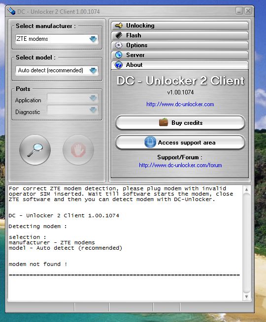

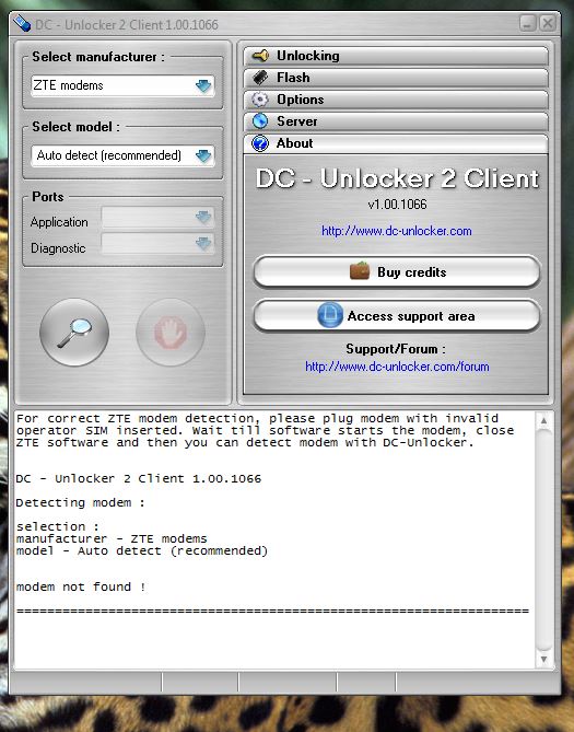

Thanks for the suggestion but that didn't work either. I tried ver. 1066 & ver. 1074, as per attached screen grabs.
As i understood you again have installed drivers/software from the modem, this is incorrect. You just need to connect mf61 to pc after installing our drivers, then stop its own installation/eject it's drive-cdrom. Then in device manager it should appear not as T-Mobile.Originally posted by Porterve View PostI uninstalled all the programs & drivers that I could find related to ZTE and T-mobile and started again.

As soon as I connect the modem it installs the T-Mobile CD & MMC storage USB drivers. When I uninstall these, there is no longer any mention of the modem (T-Mobile or anything else) in device manager, even though I previously did a clean install of your drivers. How can we be sure that your driver has been installed?
Disable automatic updater on windows, so it won't install incorrect drivers that it does now. then uninstall those t-mobile drivers again and then reconnect device to pc, it should either find our drivers or no drivers, if so then you'll need to instal lthem manually from device manager window.Originally posted by Porterve View PostAs soon as I connect the modem it installs the T-Mobile CD & MMC storage USB drivers. When I uninstall these, there is no longer any mention of the modem (T-Mobile or anything else) in device manager, even though I previously did a clean install of your drivers. How can we be sure that your driver has been installed?
