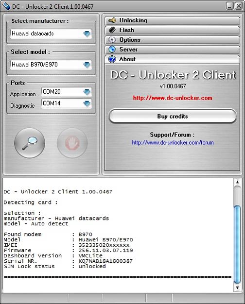

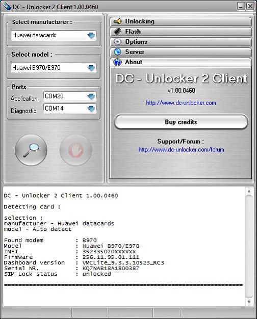

    I have a huawei b970.After i used dc unlocker it shows like this:
    DC - Unlocker 2 Client 1.00.0460
    manufacturer - Huawei datacards
    model - Huawei B970/E970
    Found modem : B970
    Model : Huawei B970/E970
    IMEI : 352335020xxxxxx
    Firmware : 256.11.95.01.111
    Dashboard version : VMCLite_9.3.3.10523_RC3
    Serial NR. : KQ7NAB18A1800387
    SIM Lock status
    : unlocked

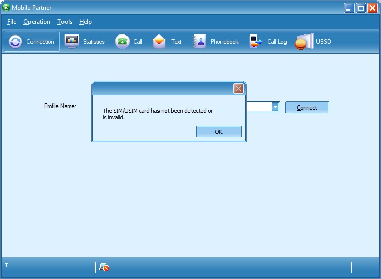

    But if i want to use it with mobile partner it says:
    The sim/usim card has not been detected or is invalid.
    Can you please help me for this?

    Was there sim inserted when you were detectind it? If so, then try detecting without sim inserted. If lock status is locked, then you need to unlock it. If lock status is unlocked again, then you can try to use not customized connection software. You can download it here: http://www.dc-unlocker.com/downloads...mised_managers

      I checked the b970 with and without sim card.Same result: unlocked.

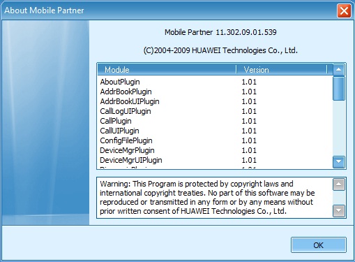

      I used non customized software and I have same result:"The sim/usim card has not been detected or is invalid"
      Could it be because of other reasons?(meybe like customized firmware?)
        Sure used non customized software from our web page? Be sure your sim card is working. Try to insert other provider sim card.

          I attach some pictures.
            If same message with all sim cards, that card not detected, most of all there is modem (modem sim connector) problem.

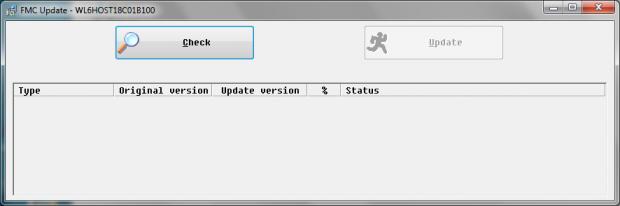

                          firmware update error
                          I attached some pictures of the update software and the error it gives.

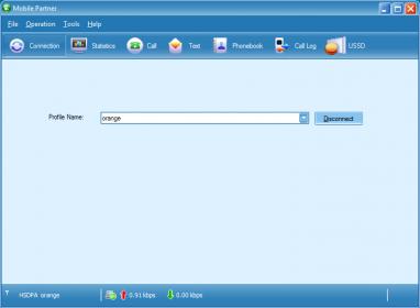

                            Hy.
                            I managed to update the firmware,and now it recognizes all types of sim cards.I can use in modem mode(with mobile partner) with any service provider.(see attached)
                            Looks like Huawei can restrict the sim cards that the modem recognizes by firmware.

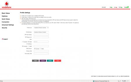

                            The new problem that I can't use in router mode with any provider(works only in Vodafone):dashboard on the router doesn't allow me to change the connection profile settings in order for me to use B970 in router mode with other service providers.
                            Is there a way to update the dashboard?

                              anybody has any ideea for B970 dashboard update?
                              Hy
                              Anybody has any ideea or suggestion how to update Huawei B970 dashboard?
                              Any help is appreciated.
